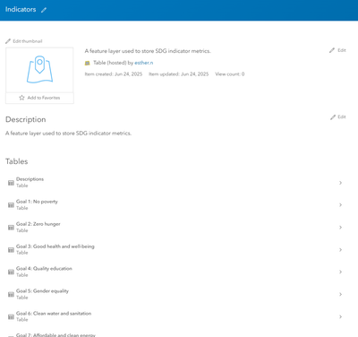

  • The indicators are stored as structured tables within a single feature layer item (screenshot attached)

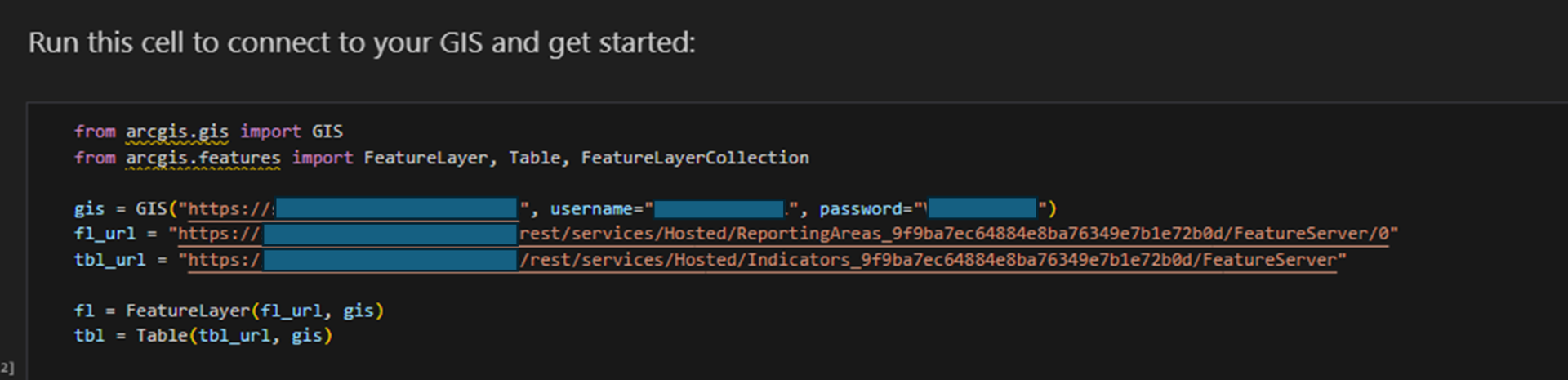

1. To test the operation, I have fetched my Feature Layer [ReportingAreas] and Table Layer [which has the individual goal layers]

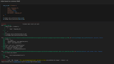

2. While indexing on the basis of the common Geography_ID field, I get a schema-related error, despite editing operations being enabled on a service level.
The intended outcome is to programmatically create joined feature view layers for each of the 17 indicator tables, using Geography_ID as the join key, in a form that is scalable for future updates.  [as shown in the first screenshot]

You can try set the sourceSchemaChangesAllowed property for a Feature Service to true, since being false is what is causing the error. You might have to do this for you table too.
from arcgis.gis import GIS
from arcgis.features import FeatureLayerCollection
agol = GIS("home")
item = agol.content.get("FS_ITEM_ID")
flc = FeatureLayerCollection.fromitem(item)
print(flc.manager.update_definition({"sourceSchemaChangesAllowed" : True}))
