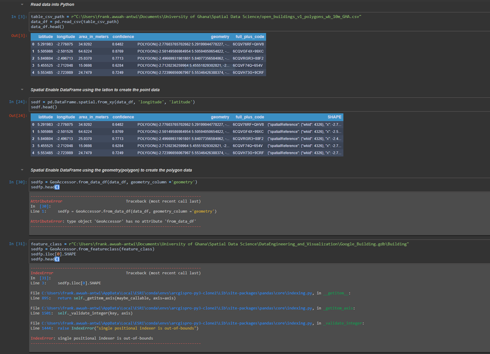

How do I Spatial Enable my dataframe with the geometry(Polygon) instead of the from_xy ultilizing the latlon which gives me point data instead of the polygon data I am after.

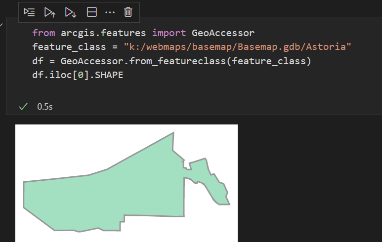

If you already have a feature class of type polygon you could load it, then you'd have the polygon type and attributes defined for you.  The feature class could be empty.

Thanks Brian for the help. I have try your solution but still needs some help to get it working. I am able to create the point data but really need to get it out as polygon using the geometry column. Have attached the image of the error. Thank for the support.

Brian's answer above is a good workflow.
But if for some reason, your workflow involves reading the data first into a `data_df`, then you can use the `from_df()` method. Please see: https://developers.arcgis.com/python/api-reference/arcgis.features.toc.html#arcgis.features.GeoAcces....
You can then pass the `geometry` column in your screenshot to the `geometry_column` argument.

Thanks AtmaMani for the help. I have try your solution but still needs some help to get it working. I am able to create the point data but really need to get it out as polygon using the geometry column. Have attached the image of the error. Thank for the support.
