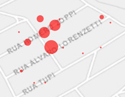

I would like to produce a map like this:
I have a spatially enabled data frame with a column with numeric values (integers). I want vary the size of the symbol by value. I have found documentation for changing colors, which works fine, but I can't figure out how to change size.

andrei_ste
Hi Benjamin,
I had the same issue and I managed to solve it with a simple renderer and a size variable defined in the visual_variables property. date_zi is my spatially enabled dataframe: solution.pngMore information related to the size variable you can find  here: https://developers.arcgis.com/documentation/glossary/size-variable
Although the examples provided in the following link are for the Javascript API for ArcGIS, they work also for the Python API since they are both built upon the ArcGIS REST API. The difference is that for the Python API you need each key to be written between commas: https://developers.arcgis.com/javascript/latest/api-reference/esri-renderers-visualVariables-SizeVar...
