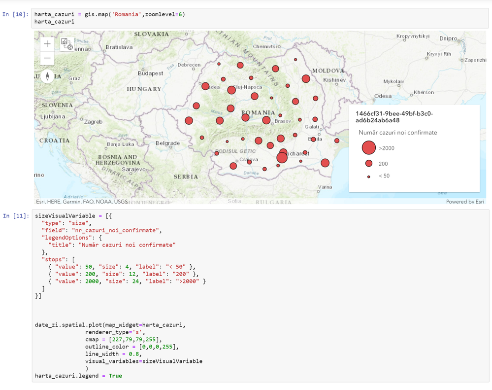

andrei_ste
Hi Benjamin,
I had the same issue and I managed to solve it with a simple renderer and a size variable defined in the visual_variables property. date_zi is my spatially enabled dataframe: solution.pngMore information related to the size variable you can find  here: https://developers.arcgis.com/documentation/glossary/size-variable
