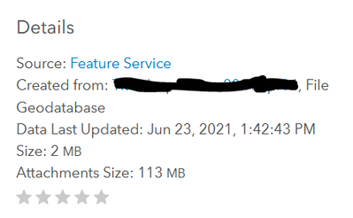

I did come across an ESRI support document that speaks to the errors I am receiving and how a map service can't access the attribute table, but according to the metadata on my hosted feature service, it is a feature layer, not a map service:

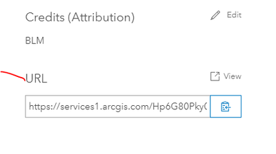

I should have posted a sample URL too.  Does it end in FeatureServer?  Then you give it the number of the layer you want.  You may be giving it the /MapServer URL instead.
url  = "https://services1.arcgis.com/Hp6G80Pky0om7QvQ/ArcGIS/rest/services/MyServiceName/FeatureServer/0"
soilpitF = arcpy.RecordSet()
soilpitF.load(url)
Sorry I should have posted the complete code.  Seems like you are trying to look it up instead?  I would just give it the URL to the service.
You get this from the Item page of the service
Hope that works.
