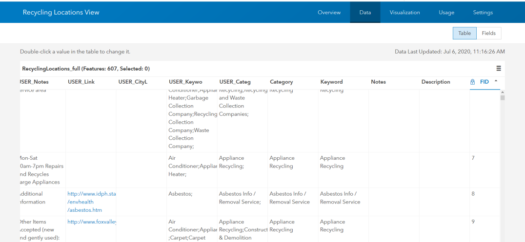

I'm trying to populate the 'Description' field in the Recycling Locations View layer (a hosted Feature Layer) with the text from the 'Description' field in the Green Descriptions layer (a hosted Table). The 'Category' field from both have the same values.

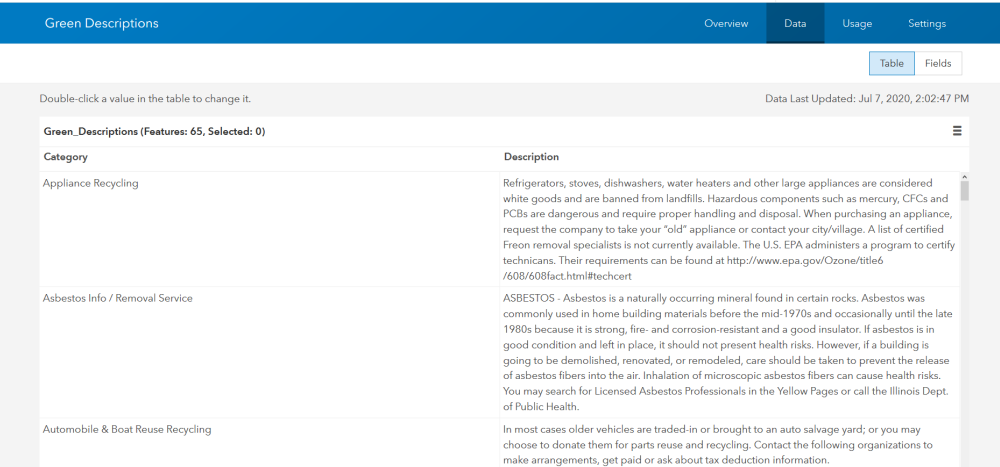

That looks like exactly what I was thinking. Making a dictionary of the categories and descriptions and then using the category as the key was 'key'. I ran into a little problem, though, that I'm currently looking into. The SearchCursor is not accepting the in_table parameter. What I thought was a table is actually a 'Feature Layer Collection', which is what is causing the error I believe.
Overview of Green Descriptions Table (created from a CSV).
