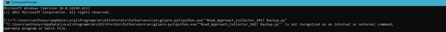

I think you're missing a space between "C:\Program Files\ArcGIS\Pro\bin\Python\envs\arcgispro-py3\python.exe" and "<your script file.py>"

Aaron,
Thanks for all your help on this. I was able to get it to run through Command Prompt and then tested with Windows Task Scheduler. I'm all setup for automating that script now.
