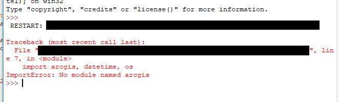

Yes, I have been unable to run it in a standalone script. I have the API installed through ArcGIS Pro but the standalone script returns an error when I try to import arcgis. Are there additional steps I need to take to get it installed?
by Anonymous User
Not applicable
What error does it show? I'm guessing "Unable to import module 'arcgis'" or something similar.
How are you running the script? Are you providing the path to the correct environment/interpreter?

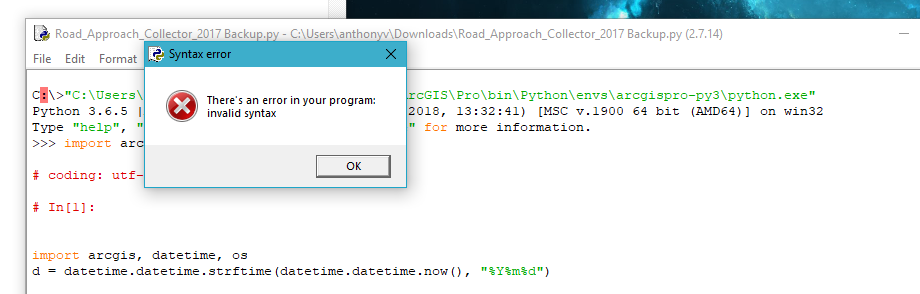

I tried to run this as a stand alone and receive this error....
by Anonymous User
Not applicable
Are you providing the correct Python interpreter. Can you try providing the full path the arcgispro-py3 interpreter. It should be similar to the following.
C:\>"C:\Program Files\ArcGIS\Pro\bin\Python\envs\arcgispro-py3\python.exe"
Python 3.6.5 |Anaconda, Inc.| (default, Mar 29 2018, 13:32:41) [MSC v.1900 64 bit (AMD64)] on win32
Type "help", "copyright", "credits" or "license" for more information.
>>> import arcgis

The IDE you have open right now appears to be using Python 2.7.14. You need to switch your interpreter to use the Python interpreter that ships with ArcGIS Pro which should be Python 3.6.5 (if pro 2.2 I think).
Try this:
1. Open command prompt
2. Type "C:\Program Files\ArcGIS\Pro\bin\Python\envs\arcgispro-py3\python.exe" and hit enter. This should launch the Python Interpreter that Pro uses. Also please check that the above path is correct for you machine.
3. Type "import arcgis" and hit enter. This should import the arcgis module
If the above works then you should be able to run the following from command prompt:
"C:\Program Files\ArcGIS\Pro\bin\Python\envs\arcgispro-py3\python.exe" "<your script file.py>"
This should run your script using the ArcGIS Pro Python Interpreter.

Oh sorry, if I wasn't clear. The steps 2 and 3 were just to test the Python API import correctly.
To run your script just do:
2. Type "C:\Program Files\ArcGIS\Pro\bin\Python\envs\arcgispro-py3\python.exe" "<your script file.py>" and hit enter
