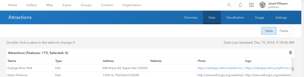

I'm looking for a way to change the file path of 100+ fields in a table of a feature layer. I have Jupyter Notebook installed. I'm guessing it can be done with Python? I'm pretty familiar with arcpy, but I've never used python inside AGOL before.
We recently set up a new server. This 'Attractions' layer (below) has pop-ups and in the pop-ups are links to images. But the file path to these images is to the old server. I want to use python to replace this old path with the updated one.

Just to clarify: you have 100+ fields or do you have a single hosted feature layer with 2 fields and 100+ records (as shown in the screenshot). If it is the latter a simple field calculation should do the job. However, if you need to walk through many fields, the Python API is the way to go.
