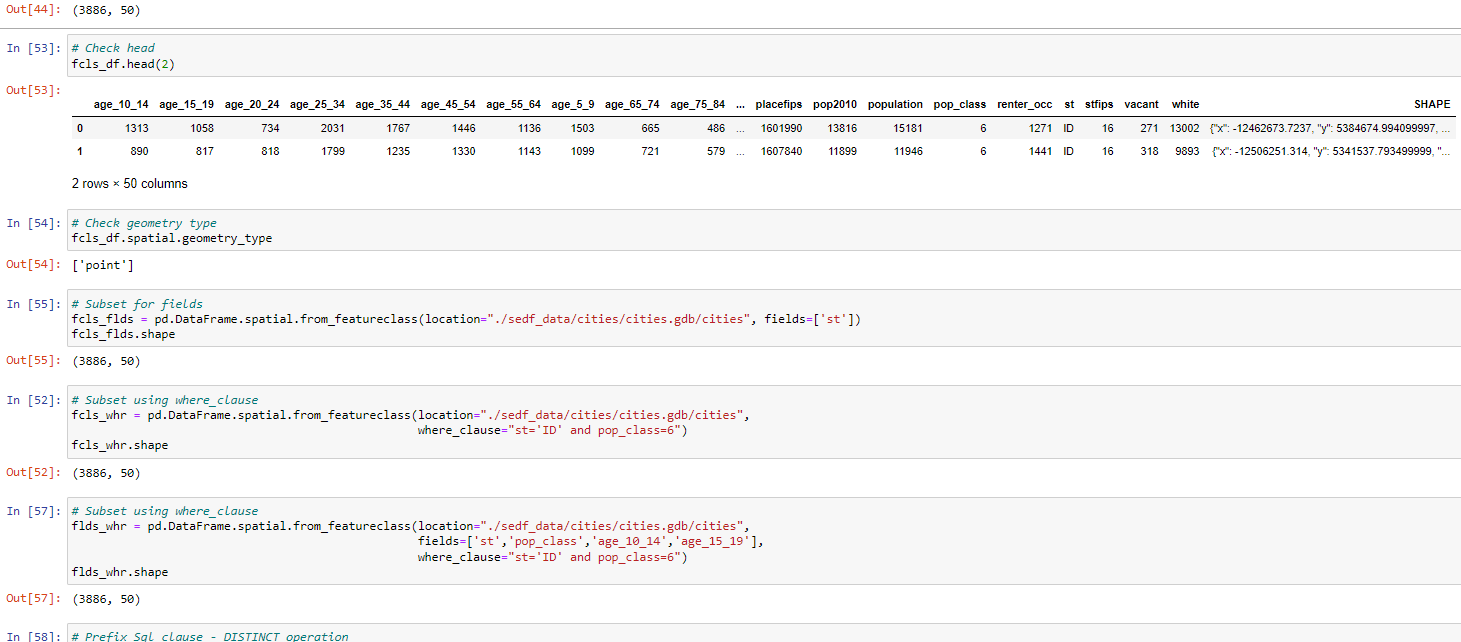

I am following a tutorial at https://developers.arcgis.com/python/guide/part2-data-io-reading-data/
When I use optional parameters from the from_featureclass() method to refine return results, I don't get a subset of the dataset. The full dataset has 3886 rows x 50 columns. It does not matter if I specify the fields parameter or SQL query or where clause, it always return the full dataset:
Any recommendations?

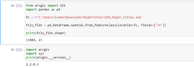

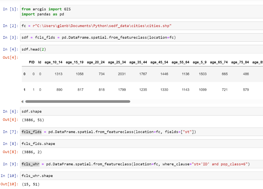

What version of the arcgis API are you using? I tested in version 2.2.0.1 and all seems to work as its should. See below in IDE and in Notebook. Maybe try a new notebook and the code below?
from arcgis import GIS import pandas as pd fc = r"C:\Users\glenb\Documents\Python\sedf_data\cities\cities.shp" fcls_flds = pd.DataFrame.spatial.from_featureclass(location=fc, fields=["st"]) print(fcls_flds.shape) >>> (3886, 2) fcls_whr = pd.DataFrame.spatial.from_featureclass(location=fc, where_clause="st='ID' and pop_class=6") print(fcls_whr.shape) >>>(15, 51)
