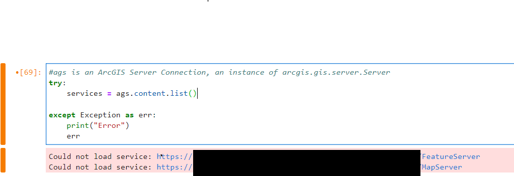

I am trying to use the Python API in Jupyter Notebook to test the availabilit of ArcGIS Server feature services. When a service is inaccessible an error message in pink is output from the notebook cell, but no exception is raised.
I would like to capture these issues to use elsewhere, is there a way to capture either the error outputs from the cell, or have the API raise an exception?

I don't know about a way to do it within the API, but you could just use requests to ping the service endpoints and parse the response.
