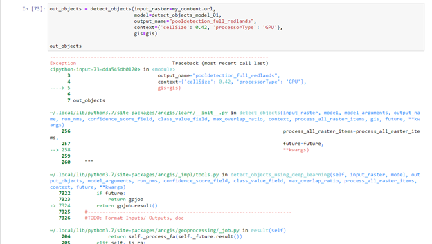

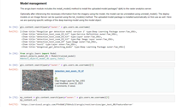

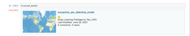

  • When I save my model, the '.zip' file does not appear. The Models folder has (ModelCharacteristics folder, ArcGISobjectDetector python file, model_metrics chrome HTML Document, .dlpk, emd, and .pth files). When I followed the references above, they used the '.zip' file for 'gis.content.add' function.
  • Instead of the “.zip” file, I used a “.dlpk” file for “gis.content.add” function.

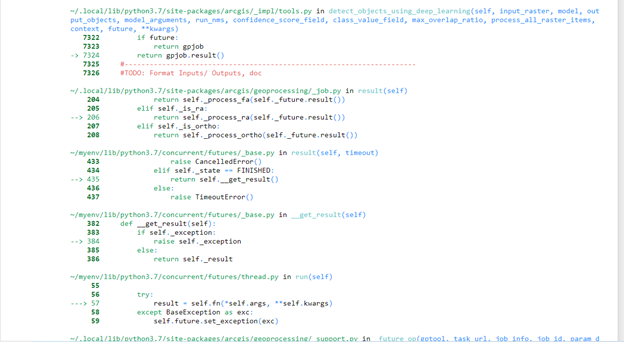

  • I shared the ".tiff" image file to ArcGIS online content from ArcGIS pro web-share
  • I followed references, but it did not work. It notices me only “job failed.” I could not figure out what is the problem.

It's not possible to run the deep learning models in ArcGIS Online. You basically have 3 options:
  • ArcGIS Enterprise with ArcGIS Image Server
  • ArcGIS Pro with the Image Analyst extension
  • ArcGIS Python API (dependent on model type)
The sample notebook you are following has the following in the prerequisites section:
This sample demonstrates how to do export training data and model inference using ArcGIS Image Server. Alternatively, they can be done using ArcGIS Pro as well.
If you don't have either Image Server or Pro + Image Analyst, there are prediction (detection) functions in the ArcGIS Python API for some models. SingleShotDetector does have one:
https://developers.arcgis.com/python/api-reference/arcgis.learn.toc.html#arcgis.learn.SingleShotDete...
ssd.predict(image_path, threshold=0.5, nms_overlap=0.1, return_scores=False, visualize=False, resize=False)
It returns a List of xmin, ymin, width, height of predicted bounding boxes on the given image.

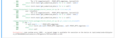

TaehyunYoon1
I faced a different problem that has not been a problem so far.
I am working on esri_learn deep learning dependencies.
The CUDA error below has not appeared before, even last night.
I re-installed dependencies, but it did not work.
Do you have any idea what the problem is?
