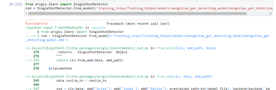

  • I followed references, but it did not work. It notices me only “job failed.” I could not figure out what is the problem.

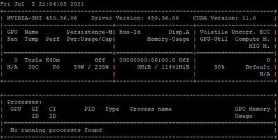

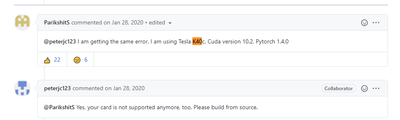

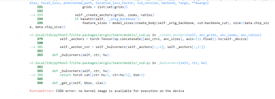

This could be indicating that your graphics card may not be supported. What model is your card?
There's a fairly long discussion here about the error:
https://github.com/pytorch/pytorch/issues/31285

I work on virtual machine and I use K40.

Have you changed anything in the environment recently? According to the following page, K40 support was removed in pytorch 1.3. The latest versions of ArcGIS are using pytorch 1.4.
https://github.com/pytorch/pytorch/issues/30532#
Maybe try finding an environment with a newer GPU - you should probably see if there's anyone in your schools IT department who could help.
