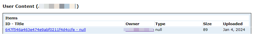

Using ArcGIS Enterprise 10.9.1 Sharing API I am able to see some `null` type items in my portal

BHK
Hi Braian
Thanks for reply. on first code
id = "647f546a463e474e9abf0211f4d4ccfe"
item = gis.content.get(id)
print(f'Title: {item.title}, ID: {item.id}, Type: {item.type}')
I am getting this error message:  Unable to find ItemInfo for item '647f546a463e474e9abf0211f4d4ccfe' (Error Code: 500)

It's just a broken service. If you can look in your Portal server "contents/items" folder, you can find the folder that has the name matching the ID and look inside.  For example on my server it's in C:\arcgis\arcgisportal\content\items.
There will be a folder there for each item and you could open the folder and look inside. For instance on my server I could look in folder "b87919419f6c4cd4a1580085f58b0c8f" and for this service there is a folder "esriinfo" and in there is "iteminfo.json" and I could dump the contents of that file in a readable way and I'd see this

In your case, well, it might tell you all about a service that used to work but is now broken, and probably you will have to delete the item folder and then reindex your Portal to make it go away.

I should add, if you cannot find the item folder at all or the folder is empty then you can probably jump right to part two, reindex your portal. It is relatively harmless to do but makes the Portal unavailable for a few minutes.
To reindex you log into your Portal Admin site, go to System, Indexer, and click Reindex.
The portal admin site is found at the same URL as the home page for your Portal but you replace "home" with "portaladmin" for example
https://bhk.somewhere.com/portal/portaladmin
