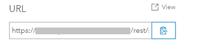

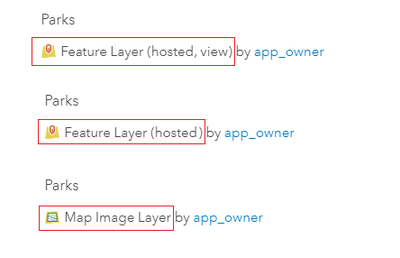

I need to retrieve two properties of   Type of Items weather is (Feature Layer (hosted, view) ,or  Feature Layer (hosted), or Map Image Layer )
and also, the URL referring into the source (ArcGIS Server Feature Service)

Hi @BHK
You get this information from the JSON of the item object. Run the code below to print out the properties of an item.
from arcgis.gis import GIS
import json
agol = GIS("home")
item_id = "ITEM_ID"
item = agol.content.get(item_id)
print(json.dumps(dict(item), indent=4))
In the type and typeKeywords you will find the information your are looking for. It is not always obvious but your Feature Service and View will be of type Feature Service, the view will have a typeKeyword of View Service in the list. The Map Image Layer will have a type of Map Service. Use the below to print out the type and typeKeywords properties for an item and the url.
import json
agol = GIS("home")
p_items = ["ITEM_ID1", "ITEM_ID2", "ITEM_ID3"]
for item_id in p_items:
    print(item["type"])
    print(item["typeKeywords"])
    print(item["url"])
This link is useful for type and typeKeyword combinations: https://developers.arcgis.com/rest/users-groups-and-items/items-and-item-types.htm
