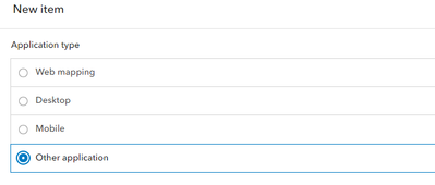

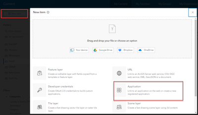

With SAML authentication, you won't be able to authenticate without user interaction.  One thing you could try is to create an Application in ArcGIS Online by going to New Item > Application:
Specify Other Application and then specify a name:

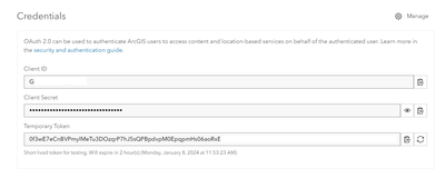

In the Application details, this will create a Client ID and Client Secret:
Using these two, you can generate a token to authenticate with AGOL:
