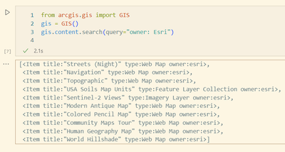

So, no special developer license. Just ability to run Python and to access an "Enterprise" Portal. I think you could use any "Enterprise" server and access its services that are shared without any username or password, just the URL. If you leave out the URL it defaults to ArcGIS Online. For example
