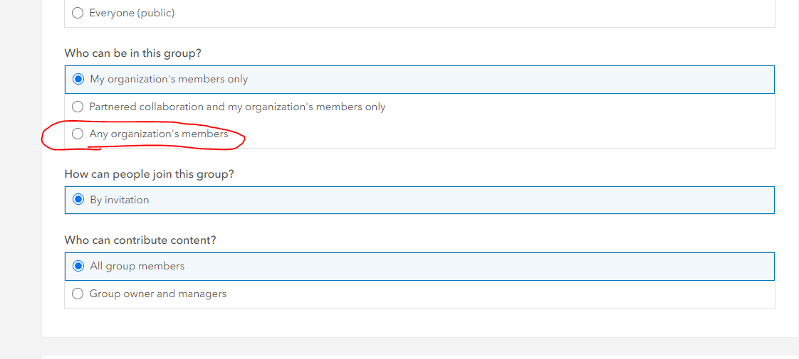

The result stays here:
The intention of the script is to assist in the creation of hundreds of groups. Not being able to specify this setting is a considerable problem.
