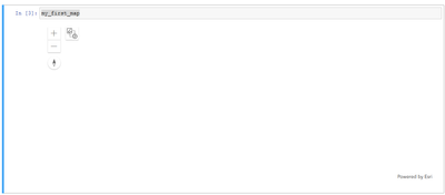

I am trying to run an ArcGis Notebook in Jupyter. I have cloned the environment in ArcGis Pro and it's running in Conda.
I can run the cells in Jupyter, and the window is loading, but the map is not loading:
Can you help me with this? The arcgis version of the package is 1.8.5

The map widget in a Notebook is going to default to the basemap and scale/extent as defined in your organization's settings, if you're signed in to one.
Try explicitly setting the basemap, center, and scale properties, as outlined in the API docs.
my_first_map.basemap = 'osm'
my_first_map.center = [your_lat, your_lon]
my_first_map.scale = 20000
my_first_map
Does that change what you're seeing?

Hello Josh,
That's the solution! I have a standard basemap in a coordinate system from the Netherlands.
Thank you very much!
