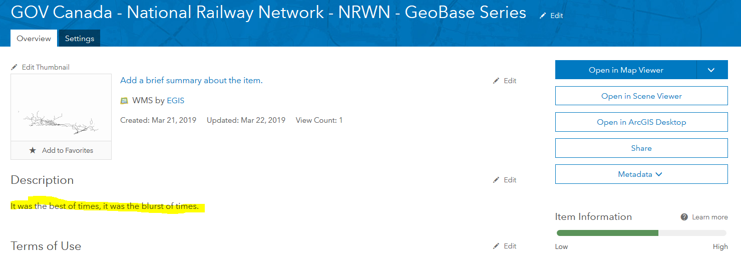

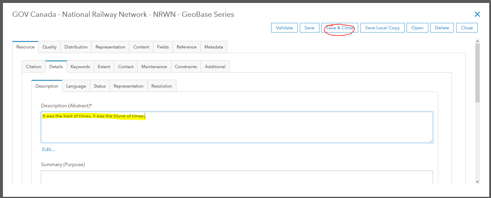

Through the ArcGIS Portal UI, when I edit the metadata for a portal item, the item's properties are updated when I save the metadata record:
However, when I update the item's metadata from the Python API, the item's properties are not updated. I've used the following 2 methods to update the item's metadata:
