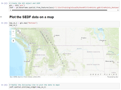

Has anyone else experienced issues with displaying layers converted from local geodatabases to SEDFs in map widgets?
in 3.2, I can't seem to see the SEDF when loaded into the map widget, but when saved into the portal, the feature layers added from SEDFs are present. I am running the sample notebook from the Visualing Data using ArcGIS API for Python.

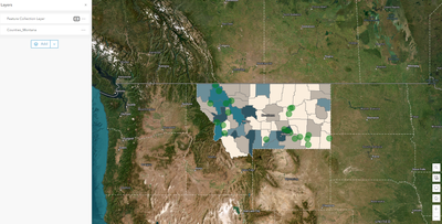

when i save the map object from the notebook to AGOL, the layers show correctly, including the points loaded into the SEDF from a local GDB

If it helps, I am using a social login, so the GIS connection i use is
gis = GIS("pro")

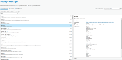

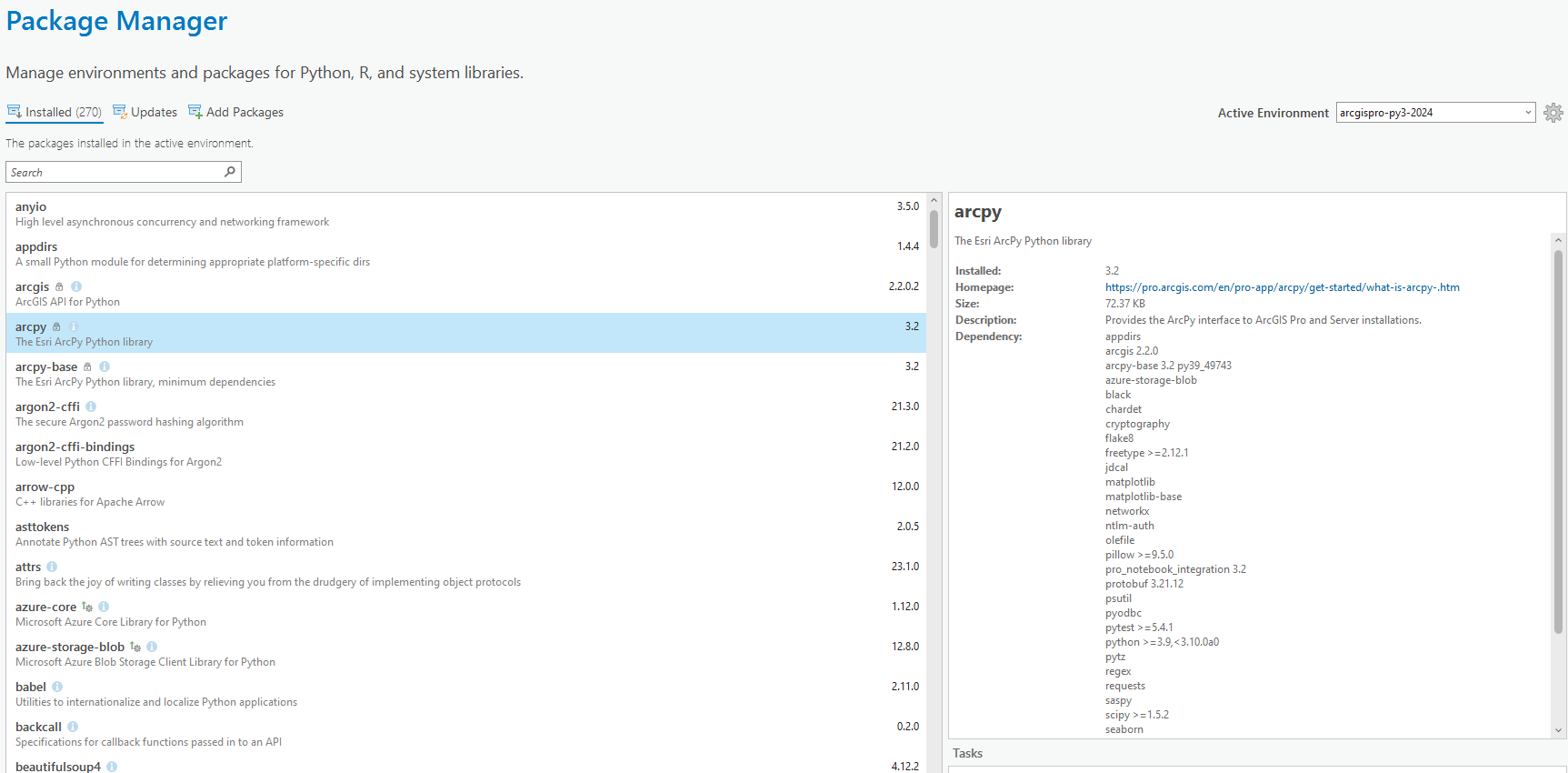

I have tried cloning my environment and updating the arcgis and the arcpy package to the latest available version via conda in the Python Command Prompt.
