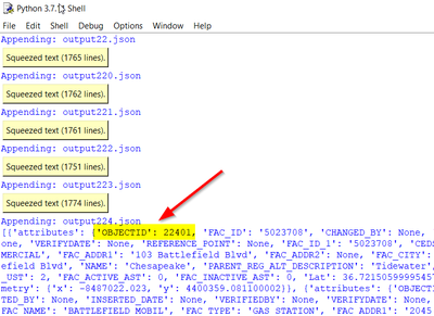

So when I scrape the Data and write to JSON files I get about 224 of them... This is set to CHUNKS of 100 records...
I have set the CHUNKS to about 100 records per JSON File.. As you can see below I am Loading each JSON file -- Grabbing the 'features' key and then using a POST to past this data.

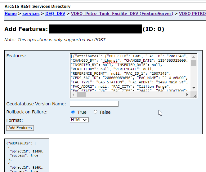

As you can see from the 2nd image below which is showing the 224th JSON file you can see the OBJECTID of 24,401
If I manually copy the JSON and paste it into the AddFeatures of Rest -- 3rd Image below it adds the 100 records with no issues... I can even do this with 1000 records ... the only reason I went down to 100 was to test if this was an issue... the JSON being to large.
So right up until I Append the Records the JSON file has the 100 records + 224 JSON files which is the 24,000+ records I am trying to add... so EVERYTHING seems good to go...
BUT only a 1/6 or so of the records make it....
