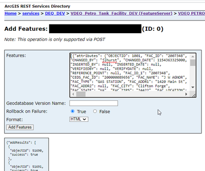

During this scrape it writes the values to individual JSON files 1000 records at a time.  I can open these JSON files and see there is an OBJECTID =1 and then OBJECTID=1000 and then the next one is OBJECTID=1001 and OBJECTID=2000 etc etc...
I can Copy that contents of that JSON file and put it in the REST Services and update from there with NO issues.. so I know the format is correct.
I read somewhere that there is a limit on characters of the JSON.Load  which I am trying in the second def below.  My files are about 830 KB in size...it appears not all of them are getting in... as I only get about 4300 of the 12k records in the Append Process...
Good news is that it does NOT Error out.  But simply does not append all the records.
If there is a limitation on the JSON.Load how do I get around it... I tried to decrease the 1000 record count in my code to make more files but that does not seem to work... Im puzzled...
