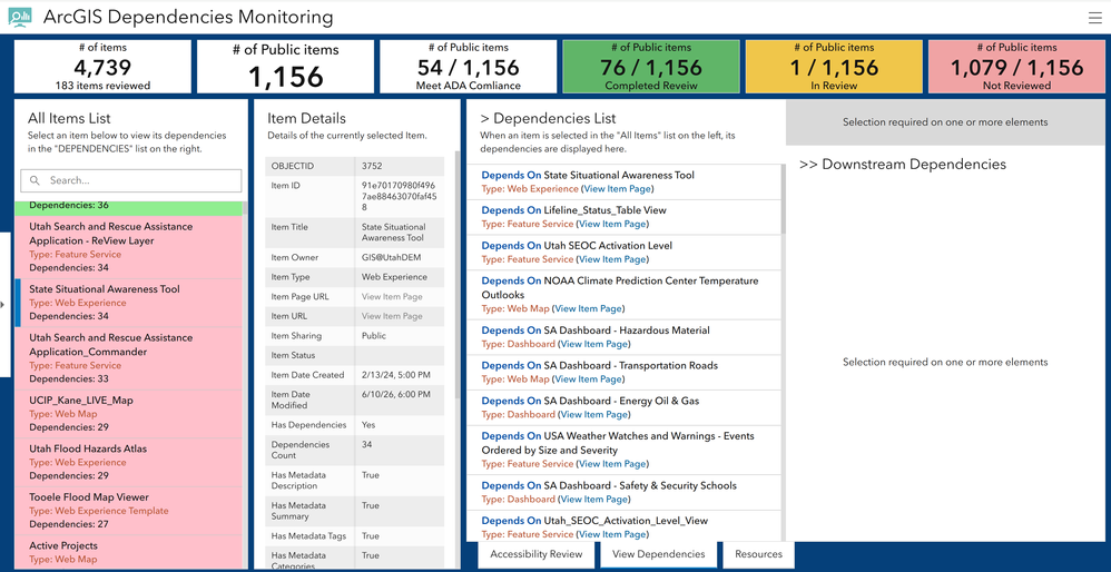

I don't think I have a solution to your problem -- but I'm doing something very similar for my organization! This script has been successfully running for a couple weeks every night and is populating/updating a layer I use in the attached dashboard (we're also using the layer to track updates to meet the new accessibility requirements).
Best of luck!
