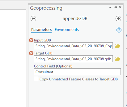

Hi all,
I recently created a "Geodatabase append" tool which, in a nutshell, batch process-appends all feature classes within a specified input geodatabase to a target "master" geodatabase, plus some optional functionality which deletes fields within the Master GDB prior to the append. The tool works great in ArcGIS pro, but I'm seeking a way to publish ONLY the tool to portal (not the dataset or reference to the dataset represented in the geoprocessing history). I've tried only uploading the schema, I've tried setting self.params.value to empty all parameters upon initialization, and nothing seems to work.
Has anyone been able to successfully do this? In general, validation has been very tricky for me to get a handle on... but my code can be found below. If there's a general process answer or a script-based answer, I'd be open to both.
I realize this might sound like a cryptic question to some, so if I need to elaborate I'd be happy to. I'm hoping that I'm just a big dummy that overlooked something in my process to reach the desired result... but I digress. My validation code can be found below, if it helps. Thanks in advance for any help!
Here's what I want to happen on load:

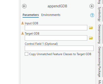

Here's what happens when I open the Published version:

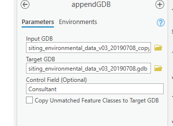

Or when I open the Schema Only Published version:
