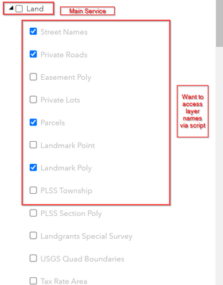

JosephRoberts2
Hi David,
Have you figured out how to access the properties of a sublayer of a service?  For instance, I'm iterating through a map that has the entire service. When my script hits this layer, it does not iterate through the sublayer of the services. It simply prints the name of the main service.
Any insight would be greatly appreciated.
