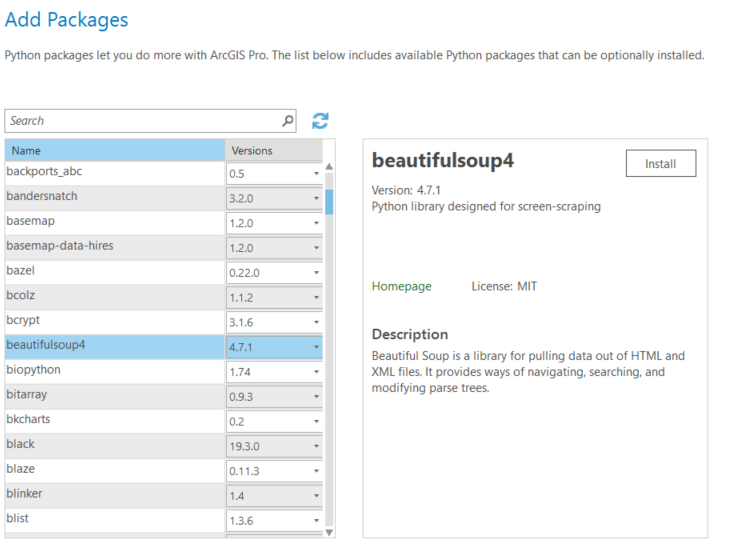

I googled bs4 and figured out it's a module named BeautifulSoup4.  I went back into Pro and added that package to my environment
