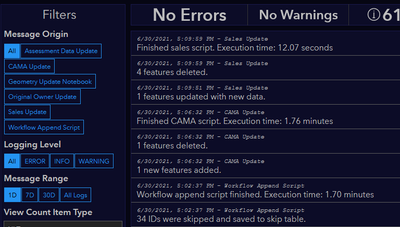

Notebook Logs
Finally, we have another hosted table that stores custom log messages from our scheduled notebook runs. Much like a standard log file, it stores a message, log source, timestamp, and message severity code. These pipe into a Dashboard List element, allowing me to quickly and easily look through recent logs and see errors and warnings right away.
The notebooks simply access the log table as any other layer, and use edit_features(adds=[...]) to add messages.
