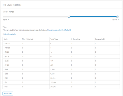

What I want to automate is the below step done in the settings of a hosted Tile layer:
Is it possible to use the API for Python to build Tiles after publishing a Tile SD file?
