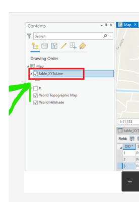

Hi,
check if out_lines are automatically added to to the map. If not add it from your .gdb. Next, right click the layer and choose Zoom to Layer. Check the attachment below.
BR,
Adam
