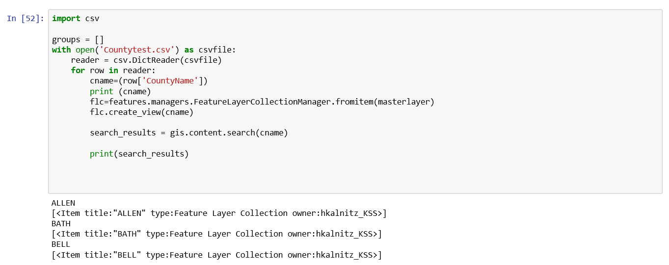

I could create county views from the master layer:

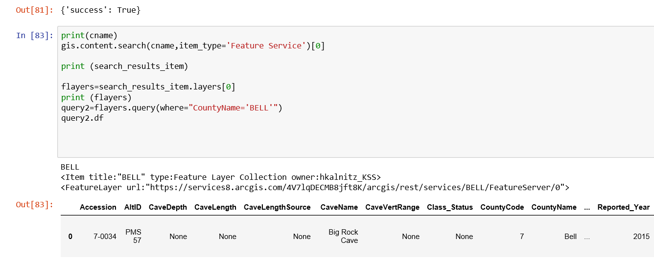

I could query each newly minted view layer by county

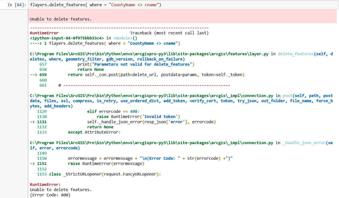

but when I try to save the query to a new layer
ok - more then one way skin the cat - I try to delete all the unwanted features from the original child view layer
Feels like I am missing something fundamental here, but I admit to being stuck. Can anyone help?

I think you just need to set the layer's viewDefinitionQuery value on each of the views. For example:
from arcgis.gis import GIS
from arcgis.features import FeatureLayerCollection
gis = GIS(username='user', password='pass')
state_item = gis.content.get('STATE_ITEM_ID')
state_flc = FeatureLayerCollection.fromitem(state_item)
state_flc_mgr = state_flc.manager
counties = ... # setup a list of county names
for county in counties:
    county_view = state_flc_mgr.create_view(county)
    county_layer = county_view.layers[0]
    defn_str = "CountyName = '{}'".format(county)
    county_layer.manager.update_definition({"viewDefinitionQuery": defn_str})‍‍‍‍‍‍‍‍‍‍‍‍‍‍‍‍‍‍‍‍‍‍‍‍‍‍‍‍‍‍‍‍‍‍‍‍‍‍‍‍‍‍‍‍‍

HowardKalnitz
Thanks J.R. !
Sorry for the delay, but I got on this again last night, and after some manipulation of the SQL term, it worked beautifully!
Thank you for the help
Howard
