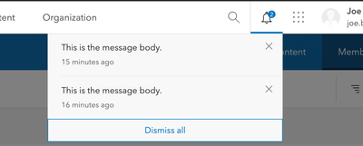

We had the same issue using the Python Group.notify() api on an AGOL notebook. The error messages seem to be misleading as I didn't have to change any user settings (AGOL or email) to get this working via the RESTful api.
I couldn't find the ArcGIS REST API documented for groups/createNotification. Looking at the ArcGIS JS REST library on github, I found the undocumented rest endpoint and called it directly via Python.
Here's the python:
import requests
from arcgis.gis import GIS
gis = GIS("home")
group = gis.groups.search(query='MyNotifyGroup')[0];
token = gis._con.token
url = 'https://www.arcgis.com/sharing/rest/community/groups/{}/createNotification'.format(group.groupid)
parms = {'f' : 'json',
         'users' : '[email protected]_somedomain',
         'subject' : 'The subject line...',
         'message' : 'This is the message body.',
         'method' : 'email',
         'token' : token
response = requests.post(url, data = parms)
JSON response:
	"success": true
The notification shows in the alert area on the user's AGOL banner:
In theory, SMTP is blocked from Python notebooks, so maybe the missing email is related to that restriction.
