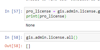

I'm working on a notebook to migrate our organization's enterprise usernames over to email addresses (to facilitate Azure single sign-on). I have most of the kinks worked out, but the one thing I haven't been able to automate just yet is the licensing. I can't delete any users that have licenses assigned, and I want to assign the same licenses to the replacement username. My problem is that the license manager seems to think I don't have any licenses. However, when I go through the Portal GUI, I can see that I have licenses available and assigned for Pro, Insights, etc.
Here's an example of what I get when I try license.all() or license.get():

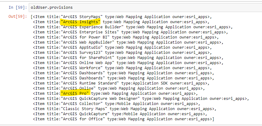

And here's what I get when I pull the provisions property for a user with Pro and Insights:

Edit (3/2/2026): For anyone who comes across this with the same issue, I think maybe what's happening is that user.provisions is specifically for add-on licenses that have been assigned to a user, not licenses that come inherently with an account type. For example, a Creator user type comes with ArcGIS Pro Basic (as of writing this in March 2026), it isn't manually assigned and can't be removed.
What I ended up doing was looking at gis.users.license_types (which returns a dictionary of user account types in your org and all the apps/bundles/extensions that the account comes with) and pulling info from it based on the user's license id (user.userLicenseTypeId). Here is a function I wrote to pull the account's inherent ArcGIS Pro license, extensions, app bundles, and a full list of apps within those bundles. The "user" input in the function would be a user object, like you'd get from gis.users.search().
