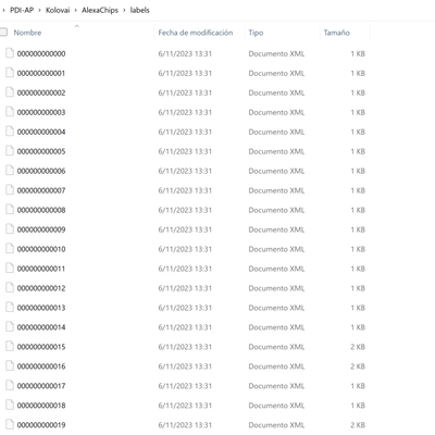

AlexaVerónicaGarcíaBarrantes
Hi Javier
specifically where do I replace all commas to points? I went fo the folder created after exporting the training data and all the files look like in the picture. I don't see any points or commas, should they be created differently?
AlexaVernicaGarcaBarrantes_0-1699299378611.pngAlexaVernicaGarcaBarrantes_0-1699299378611.png

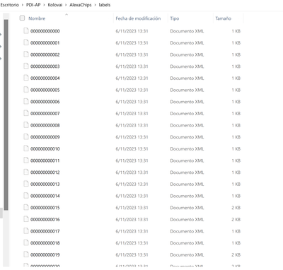

Hi Javier
I replied to your thread before but seems like it didn't upload
Specifically, where do I replace the commas to points, after creating the image chips I went to the Label folder and they all look like in the picture. Are they supposed to be in a different format?
AlexaVernicaGarcaBarrantes_0-1699303322678.pngAlexaVernicaGarcaBarrantes_0-1699303322678.png
