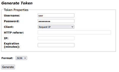

In a browser, if I hit the generateToken endpoint (via html) with the credentials and the 'Request IP' <Client> parameter, I seem to receive a valid token:
JSON response:
  "token": "blahblahblalyjfkutrk8htdkhg-khfu4twujt73g0irsdkgjh",
  "expires": "1698816744485"
Accordingly, I can access the admin endpoint and do various admin things from my machine in a browser using the same credentials.

I believe my issue is that the parameters the generateToken function accepts (at least as enumerated therein) are only user and password. I suspect with our deployment architecture the username/password are not enough to generate a token and what is also needed is the 'request IP' (the proxy server's IP).
In any case, now it seems I should probably try to get a token response via a separate REST call to the generateToken endpoint and pass it as a parameter to the Server() method, or attempt to pass the additional generateToken parameters here directly.
