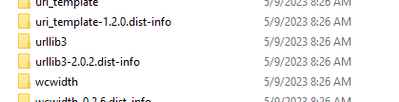

I looked at the urllib version that got installed when I created a project a while ago using pip install arcgis==1.9.1. The version of urllib3 that got installed at that time was 1.26.12
Today I created a fresh new Azure Function and used pip install arcgis==1.9.1 and the version of urllib3 that got installed today is 2.0.2
So, something changed recently in Esri's specification of what version of urllib3 to use, even for older versions of arcgis api. Apparently the update in terminology to replace "whitelist_methods" with "allowed_methods" has proceeded in urllib3 but has not been updated in arcgis api.
