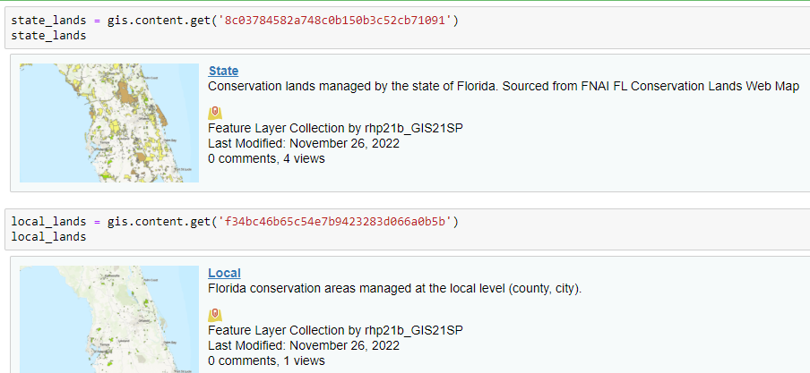

Hello, I have been struggling to open the attribute tables for these data layers. I want to be able to view the TOTACRES field, and use that to view the sum of that field. What would an example look like to view attributes?
These are the layers I brought in already

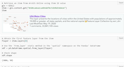

Hi @RoslynPeters - thanks for the question.  You can read in the feature layers as Spatially enabled dataframes (SeDF) and work with them as you would a traditional Pandas dataframe.  You can use the code snippet to retrieve the feature layer and convert to SeDF from this link

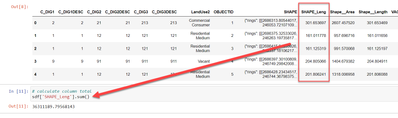

then use the .sum() function to calculate the total from the column you need.
