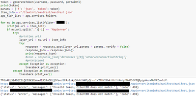

Hi David, I am getting a similar error in a standalone ArcGIS Server 10.5.1. I am trying to view a map services' item information (url = ServerURL/admin/services/ServiceName.MapServer/iteminfo/manifest/manifest.json).
I am able to generate the token but when I get the error as a response.
Any ideas on how to resolve or troubleshoot? This error does not occur in ArcGIS Enterprise 10.8.1

Hey David, at the time I didn't realize I could get to the manifest properties from the service object 😑 (i.e service.iteminformation.manifest). Doing so revolved my issue.

Hi Lin, I ended up just getting to the manifest info through the service object.
services = gis_server.services.list()
for service in services:
   man = service.iteminformation.manifest
   print(man)
