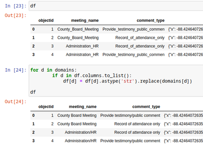

Once you have a domains dict, you can use the field name and attribute value to swap in the appropriate domain descriptions.
domains['fieldname'][feature['attributes']['fieldname']
Or if you use a dataframe, you can replace all the domains with their descriptions in one go:

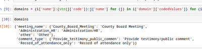

With a feature service, you can use the properties to pull out domains for each field.
Once you have your service, you can use this one-liner to cobble together a dict of the layer's domains:
service = gis.content.get('some itemid').layers[0]
domains = {i['name']:{str(j['code']):j['name'] for (j) in i['domain']['codedValues']} for (i) in service.properties["fields"] if 'domain' in i and i['domain'] is not None}
- Josh Carlson
