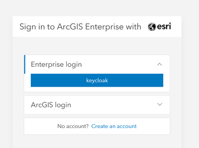

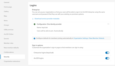

Hi @zx, so it looks like you are using SAML with SAML you will always have the token that you have to past in and for automation you have to use a built-in account.
if your login looks something like this blue button for SAML e.g. you windows and a ArcGIS login below then you have mixed mode setup for portal, otherwise you only have SAML.
your admin can find the setting under security if they are willing to turn mixed mode on.
If you have mixed mode then ask you company to create a normal portal user not SAML then move the content there and login normally

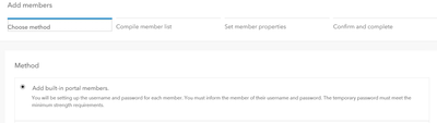

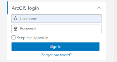

Hi @zx,
The buil-in identity provider is the login system that comes by default e.g. when you log in  using the below part this is using the buil-in identity provider when domain authentication is not setup.
On the ArcGIS API for Python .
You can still use it you will just have access to your own content when you are not Administrator.

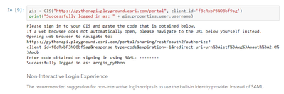

@JoshuaBixby
this is returned when logging in via the OAuth2 application authentication flow with the GIS() class.
we have custom roles which no longer allow us to interact with the API after upgrading to 10.8 - something that I think doesn't make sense, because we should only be able to change / add / update content that is owned by us anyway right?
Have you ever ran a script that was triggered automatically? how did you handle logging into the API? were you using SAML? which type of authentication scheme would you recommend?

zx
@JoshuaBixby
gis = GIS('myportalURL', client_id = 'myClientID')
this code.
Note: I know that this seems to be a permissions issue, Im just wondering when Single Sign On is configured (OAuth2.0), what is the optimal route to log in to the API automatically, with zero User Interaction? this particular flow requires the user to paste the authorize code to get a token. but if I need to log in automatically that will not be possible.
