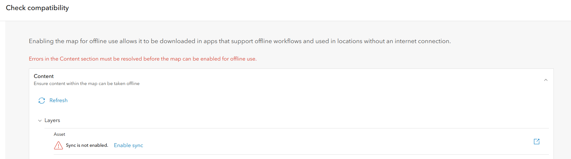

I want to enable sync in the webmap !
My workflow is :
1. Create a zip of a gdb
2. Upload the zip
3. Extract and create the hosted feature layers
4. Enable Editor tracking on hosted feature layer
5. enable sync in the hosted feature layer
6. Create a Webmap
7. Add hosted layers to the webmap
5. enable sync in the webmap

There are no errors but sync are not getting enabled in the webmap. Refer to the screen shot:
 Please let me know how to resolve this issue.
Jeremiah_Martin
I think you need to look at your content.  It says there are errors before it can be used in offline mode.

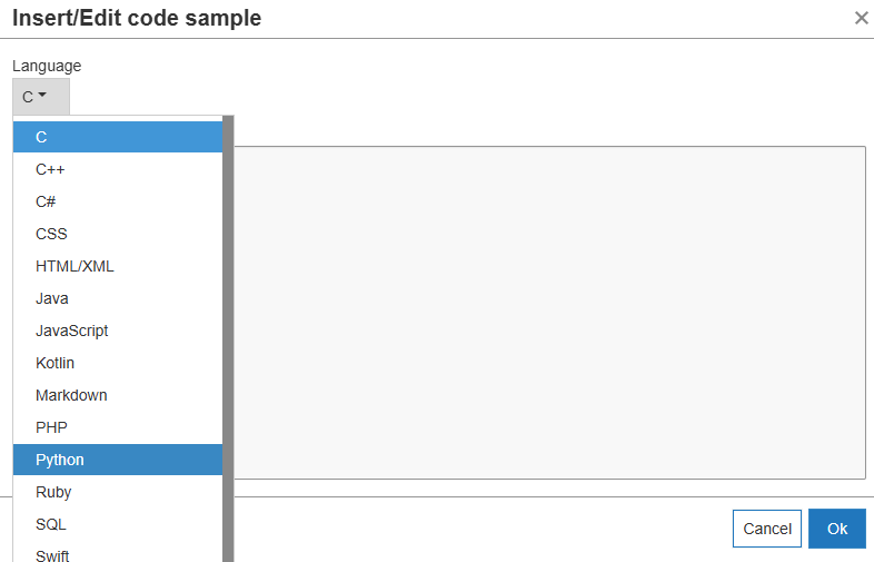

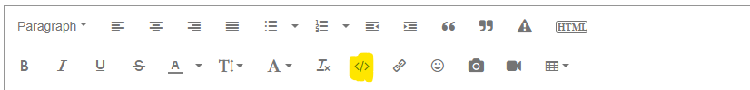

Select the ellipsis (...)
Select Insert/Edit code sample...
Select Python from the language dropdown
