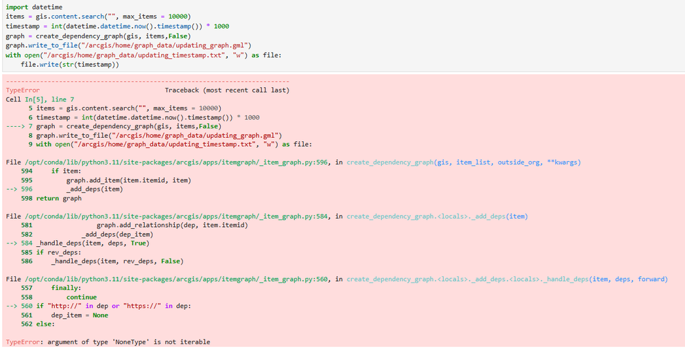

I am having issues with the Item Graph module failing when running the create_dependency_graph function on my organization's ArcGIS Online in Notebook. I'm the main administrator for the organization and yet it fails with an "(Error Code: 403) Exception: You do not have permissions to access this resource or perform this operation."
When running the script on other organizations that I have administrator access to the graph gets created just fine. I have tried running the script with "outside_org=False, include_reverse=False" thinking that maybe permissions from outside organization layers were causing the create_dependency_graph function to fail. I have been following along with the following ESRI Documentation Working with an Organization-Wide Dependency Graph  Are there exceptions that I'm unaware of that could be included in the script to skip over, but list potential items that are causing issues for the create_dependency_graph function?
Below is an example of the script, with the added inputs of "outside_org=False, include_reverse=False" from the Item Graph documentation, however it continues to fail. The script always fails at graph = create_dependency_graph...., but it will work if I limit the max items to a small amount. This leads me to think there are some items that corrupt or not able to work with the graph?

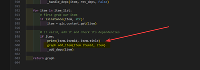

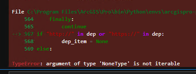

I dug a little deeper and followed the Python error message down to a file in the ArcGIS API for Python called _item_graph.py where I added a print statement to print out which item id it was processing. In this way I was able to see that, for me, it seems to be failing on some hosted feature layer views that were created by Survey123 and are referenced in an Experience Builder application. When I took one of those item ids, I couldn't find any item with that id using the ArcGIS Online user interface, nor using the gis.content.get() method.
Interestingly though, from the Experience Builder app json I could see the service URL and when I attempted to access that with a valid token, it would say that I did not have permission. If I deliberately changed a character in the URL it would report no such service exists. Which suggests that something does exist that I don't have permission to access which I don't currently understand why not.

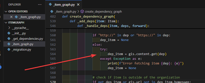

In order to process everything else, I added a try/except to skip those items. Obviously, this is just a workaround and I'm still trying to find out what those items are and if they are in use. If you felt confident in doing this and accept the implications, then this would be a way to at least process everything else. And give you a list of the items that didn't work.

Like you suggested Paul, we've wrapped it in try/except, except we don't raise an exception- it just essentially adds it as a node and moves on to the next one, meaning it will show up later as one of the "broken" items in your graph. If you're curious about the items where this specific case is happening and want to differentiate it from other items that aren't retrievable, I would recommend adding code under the "except" section to write the ID of the item to a log- that way, you can execute creation of the graph and identify each one of these items in one single go.
Interestingly enough, this is actually more a problem with our `content.get()` method, as opposed to the graph creation method, as usually an item will be returned as None if it's not retrievable- these items seem to be some sort of case not captured by that logic. We will examine whether we are correct to keep raising an error in this situation, or if we can add a warning and group it in with the others that return None to avoid errors like this.

I'd been trying to follow along with the https://github.com/Esri/arcgis-python-api/blob/master/samples/03_org_administrators/org_wide_depende..., as previously described, but I too hit this error.  Using the Notebook in ArcGIS Online.  Finally figured out how to "update runtime" from the Notebooks gallery.  But no matter how much I update, I still get the error!
NoneType Error after following ESRI githup example notebook, using AGO Notebooks (Advanced v12)NoneType Error after following ESRI githup example notebook, using AGO Notebooks (Advanced v12)
