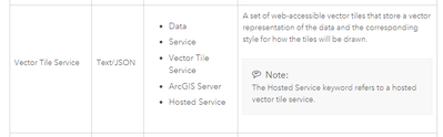

Has anyone found a solution to the OP's issue which relates to Vector Tile Layers and not Web Maps?  I'm encountering the same issue with trying to automate the refreshing of Vector Tile Services.  My script uses the same methods as the OP to upload a new vtpk, publish a vector tile service from it and then replace the production service with the new service.  When it does this, it looks like everything except 'offline' mode is maintained.  The production service has 'offline' mode enabled, but after replacing it, the 'offline' mode is disabled.
I don't think the method for enabling offline mode on web maps via the typeKeywords will work for Vector Tile Services as 'Offline' isn't a listed keyword for this item type.
