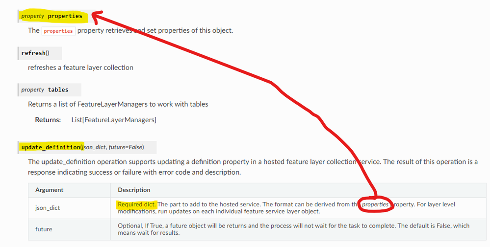

@JakeSkinner  - Where can I find documentation on these options? If I go to the documentation for FeatureLayerCollectionManager, that has the update_definition method, which says it's just like the 'properties' property, but that documentation is missing.
I'd love to know more about this specifically, but in general, I often find myself in cases like this where I'm passing in JSON or a dict and it's real guesswork as to what all the options are. After hitting a dead end on the documentation, I end up googling for an answer, which leads me here to GeoNet or to the samples. Sometimes, these solve the problem, but not always, so I'm wondering if there's a better way. thanks.

davedoesgis
@JakeSkinner  - Yeah, I often put my IDE into debug mode to view the properties of something. When it's an object with properties, that's usually all I need (in this case it's a free-form dict, so not helpful). Or if I can, I use AGOL Assistant on an item with the properties I want to emulate (in this case, you have to guess that extract means export). Or I use Google and find other users wandering around in the dark helping each other. But none of those would be necessary if there were even a base level of documentation! Can you tag some people at Esri or forward a link to this thread to show them how frustrating this can be? The screenshot I posted above perfectly illustrates how much documentation is missing.
