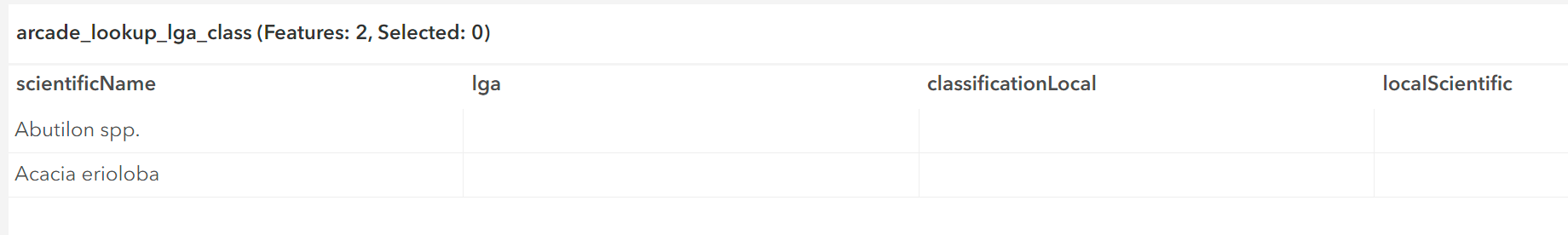

  • ISSUE: only Scientific name data comes through... other fields are blank.
    This same issue happens on two tables i.e. scientific name comes through, everything else blank. It doesn't matter if I do all records or just a subset (two in the examples below).

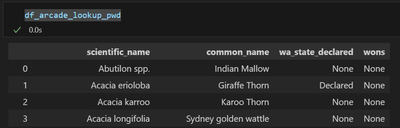

I first read in my data from SQL db as a Pandas Dataframe:
Then iterate through the rows to create the list of dictionaries (the edits).

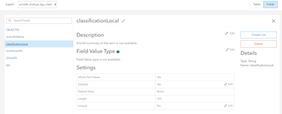

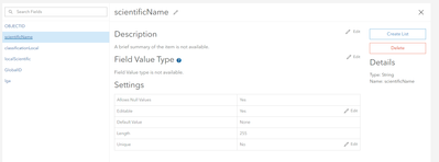

BijanTaheri
Can you post the field overview? Maybe your fields aren't configured as String or they have domains on them?
nate0102
Hello @BijanTaheri thank you for your response. Please see below images.
All strings, no domain.
