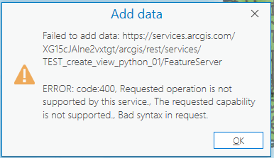

I copied the definition query from a view I manually created in a browser, so I'm pretty sure that's correct. It runs without errors or warnings. The new view shows up as an AGOL item, but when I add the view to a webmap, I see this error:
And adding it to a map in Pro gives me this:

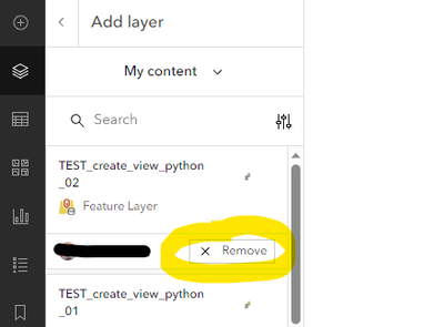

If I use the "Add" button, the view shows up. If I click the "+Add" button, it changes to an "X Remove" button, but nothing shows up in the layer list or renders on the map.
