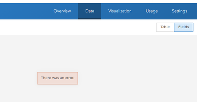

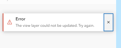

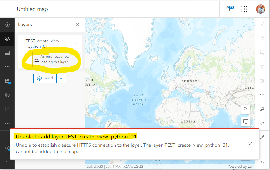

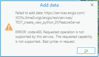

I copied the definition query from a view I manually created in a browser, so I'm pretty sure that's correct. It runs without errors or warnings. The new view shows up as an AGOL item, but when I add the view to a webmap, I see this error:
And adding it to a map in Pro gives me this:

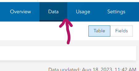

I can add it to Pro and it renders fine, but the popups are just a regular attribute field display, not my custom popup.I went to edit the popups in my layer and found that the Visualization tab (where you set the popup) is missing!
When I click "Open in Map Viewer", nothing loads.

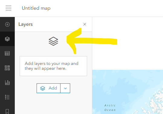

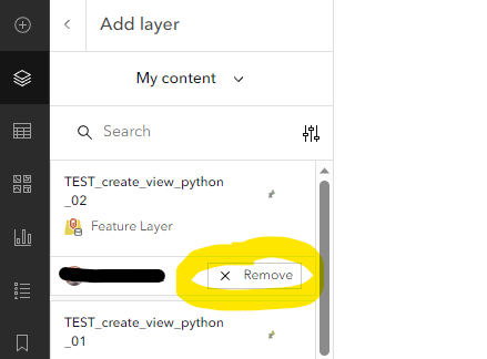

If I use the "Add" button, the view shows up. If I click the "+Add" button, it changes to an "X Remove" button, but nothing shows up in the layer list or renders on the map.

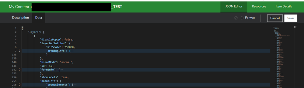

I ran into a similar issue with the visualization tab and data not appearing when using the ArcGIS Python API to generate a view.
In my case the issue appears to come from a possible bug in the API when a sublayer ID in a Hosted Feature Service does not start with 0, in mine they started counting at 12. When I looked at the API published View Layer's configuration JSON in ArcGIS Assistant, I noticed that the "Data" tab was completely empty, none of the parent service's layer JSON settings carried over as expected:
If I go to the source Hosted Feature Layer and copy and paste its JSON then the layers start to function as expected:settings_pasted.png
Here is a modified script that adds an extra step of updating the the View's configuration JSON to match the Hosted Feature layer:

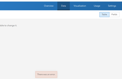

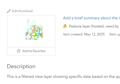

Empty Data:
What's odd is that the Thumbnail is actually generating the correct image of what would be the filtered data:
If you try and manually update this feature view's definition, you get an error as well.

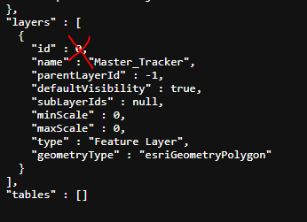

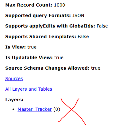

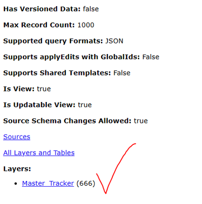

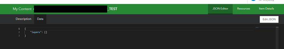

I have some filtered views I've created manually from the same source layer, and i look at their feature server data:
Working View:
Bad View:
Bad JSON:
Any assistance would be appreciated
