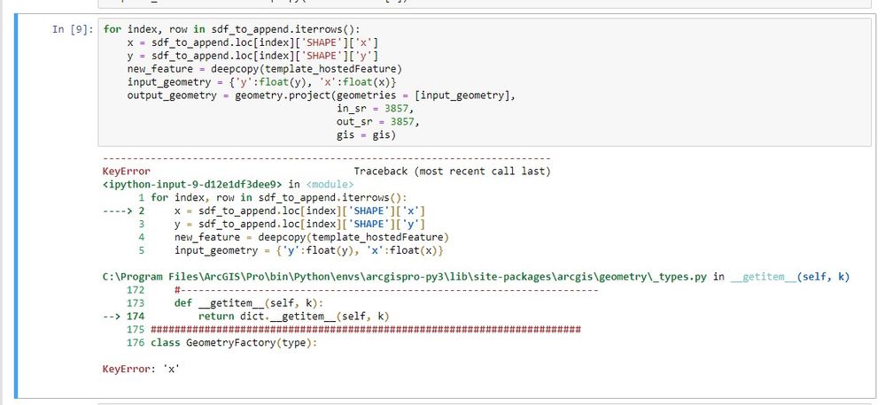

KeyError 'x'.
Is that because your script is for point data?  I would like to append to a polygon dataset.
