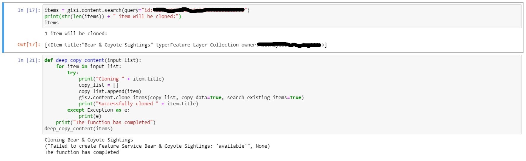

I am trying to copy (clone) content from one ArcGIS Online account to another. I have a Python Script that I am running through notebooks. I keep getting an error:
("Failed to create Feature Service WebMapName: 'available'", None)
I am at a loss for how to fix this

what is gis2 ?

I think I figured out the issue. I am thinking it isn't working because I was trying to move the feature layer to a public account and public accounts can't host feature layers
