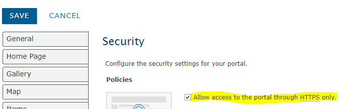

In case anyone else strikes this, the API seems to revert to http if Portal isn't set to only allow for HTTPS connections in the Portal's Security settings (you need to be an admin to have access). As soon as this was changed the error disappeared and the clone function worked going between two 10.6.1 Portals
